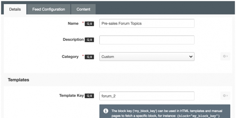

The first thing we need to do is create our blocks. We're going to create a block for each of our forums. You can set whatever parameters you want here, but the important thing is that they're named consistently using the forum ID. So, for my forum ID 2, I've named the block forum_2. This will allow us to include our blocks later.
Creating one of the blocks we'll need

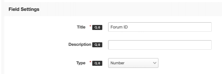

Next we'll need to create a field in our Pages database that will be used to set the forum ID that is going to show in each record. For simplicity, I'm creating a Number field and I'll enter the forum ID manually, but if you wanted to go further, you could create a Select Box field, with the key being each forum and the value being the name. This would give you a friendlier input from which to select the forum for each record.
Here, though, I've just created the Number field, and named it Forum ID.
Setting up the database field

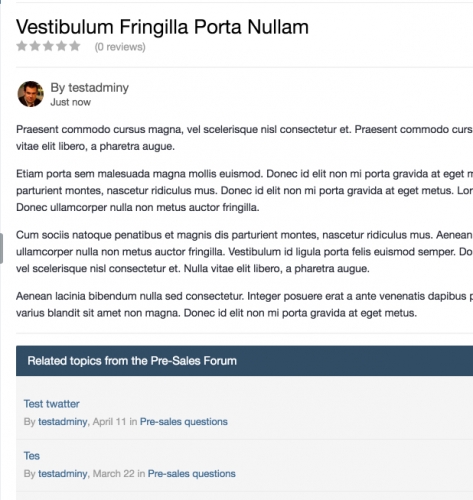

That's it - that's all you need for this to work. It's very simple. All we're doing is passing the $formValue of the field (which is the raw value) into the {block} tag as a variable, so that the block that is rendered depends on this value. As long as a block exists with the correct key, it'll be shown in the display view:
Vestibulum Fringilla Porta Nullam - Records - IPS Community Suite 2016-05-08 12-34-53.jpg
End result, with the correct block pulled in based on the ID we provided to the record
