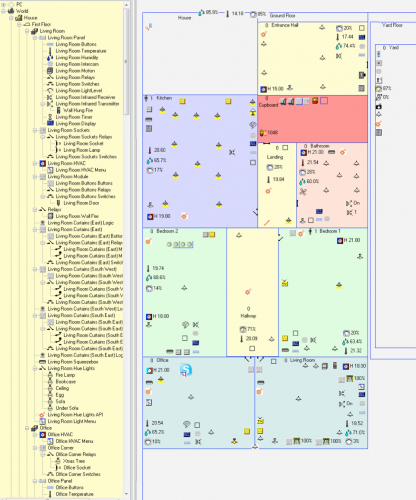

This is a hobby of mine so might be a long answer! When I fully renovated my apartment I took the opportunity to go wild and put structured cabling and do all the prep work for a complete system. I use a system designed and manufactured by a company in my local area (Idratek.com) as the “controller” which handles heating, lighting, presence detection, intercoms, door locks etc and binds everything together. I installed everything myself and in total used about 2km worth of cat5e wiring with hidden magnetic reed switches recessed in door and window jams. I’ve then extended this by adding integrations with other things such as Hue lighting, automated curtains, zoned heating, a smart kettle and cameras etc. A particular favourite of mine is the integration with Logitech Squeezebox. If somebody rings the doorbell or calls me on Skype then the volume automatically decreases in the room I’m in so I can take the call.
This system goes beyond the mainstream ad hoc automation kits such as Hue and other retail “smart” products in that it’s not just motion detection but presence. So for example if you’re in a room and the doors and windows are closed the system knows you are in that room until the door is opened. So if you’re sat still reading the light won’t turn off on you but it will still turn off automatically as soon as you leave. There’s no relying on extended 10 minute time outs. Lighting is controlled using internal and external light level sensors too so there’s no messing about adjusting the on/off times with seasonal changes.
The system has all the usual smartphone controls but the idea is that it is truly “smart” in that once set up there is little intervention required. Heating is weather compensated for example and although curtains open automatically once the sun comes up, they won’t do so if you’re still in the room to prevent inadvertent flashing to neighbours. If you open a window in a room then the radiators in that room and connecting rooms are automatically switched off so you’re not wasting money heating the outside. I like to kid myself that I’m saving money but in reality the money I have spent probably exceeds any savings I will make in two lifetimes. So if I’m not saving money at least I’m being eco friendly whilst having some fun seeing how far I can push the tech.

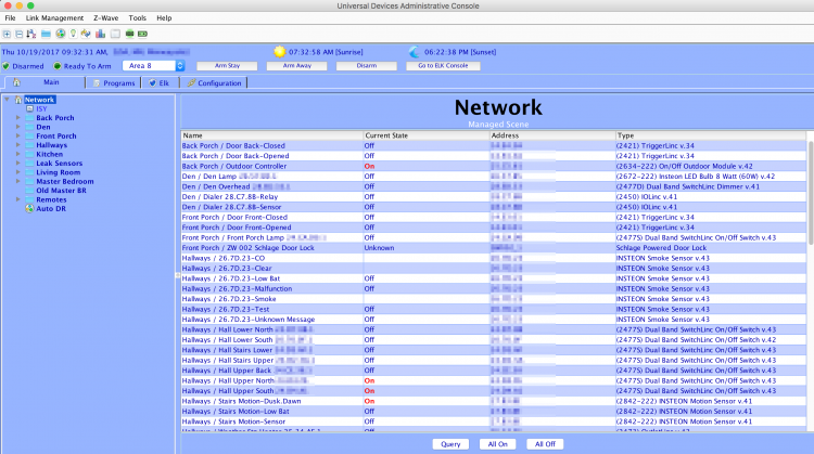

I use an ISY-994i by Universal Devices, which controls *almost* all lights in the house, the door locks (Schlage Z-wave), and is integrated with my:
  • Elk security system
  • OneLink fire/CO alarms
  • 3 Raspberry PI's with temperature sensors (DS2482-100 I2C to 1-Wire IC)
  • Logitech Harmony
  • Davis weather station (Vantage Pro 2)
59e9d579ab83f_Pastedimageat2017_10_1909_32AM.thumb.png.b31783697ca67cce0fb793256d714806.png
The mobile App I use to control this all, is Orchestrated Mobilinc.
