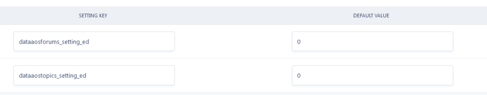

1 hour ago, DawPi said:
Did you added that setting key in the plugin dev settings tab?
yes
setting key:
Spoiler
Firefox_Screenshot_2022-09-23T16-22-40_174Z.thumb.png.4044e765b024066f23adcfd84b010882.png
setting.php:
//<?php
    $form->addTab( 'dataaos_setting' );
	$form->add( new \IPS\Helpers\Form\YesNo( 'dataaosforums_setting_ed', \IPS\Settings::i()->dataaosforums_setting_ed, FALSE, array(), NULL, NULL, NULL, 'dataaosforums_setting_ed' ) );
	$form->add( new \IPS\Helpers\Form\YesNo( 'dataaostopics_setting_ed', \IPS\Settings::i()->dataaostopics_setting_ed, FALSE, array(), NULL, NULL, NULL, 'dataaostopics_setting_ed' ) );
    $form->addTab( 'dataaos_about_plugin' );
    $form->addHeader( 'dataaos_about_text' );
    $form->addHeader( 'dataaos_support_links' );
if ( $values = $form->values() )
	$form->saveAsSettings();
	return TRUE;
return $form;
ArashDev.net
4 minutes ago, DawPi said:
Where is that setting key here?
Sorry, there was a typo
<!--mothod 1-->
<li {{if settings.dataaosforums_setting_ed}}data-address="location"{{endif}}>
<!--method 2-->
<li {{if \IPS\Settings::i()->dataaosforums_setting_ed == '1'}}data-address="location"{{endif}}>
ArashDev.net
