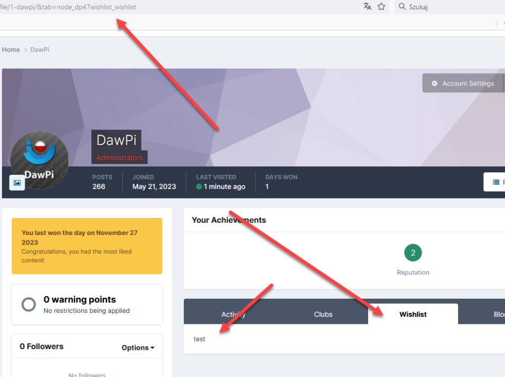

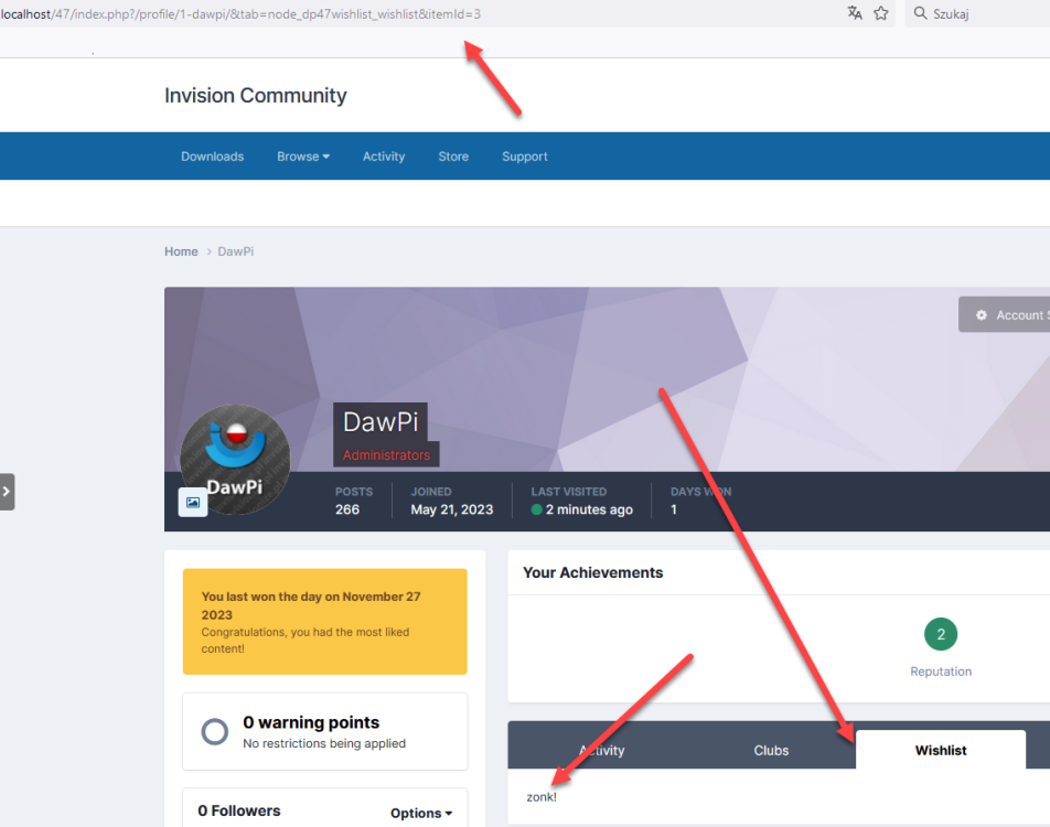

	 * Display
	 * @return	string
	public function render(): string
        if( isset( \IPS\Request::i()->itemId ) && \IPS\Request::i()->itemId )
            return 'zonk!';
        return 'test';
Efekt bez itemId:
I z:
