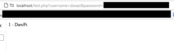

Masz całe, oczywiście zmieniłem POST na GET do testów:
<?php
require_once('C:/wamp/www/45/init.php');
\IPS\Session\Front::i();
if($_GET['username'] && $_GET['password'])
	$login = new \IPS\Login();
	foreach ( $login->usernamePasswordMethods() as $method )
		try
			$member = $method->authenticateUsernamePassword( $login, $_GET['username'],  $_GET['password'] );
			\IPS\Login::checkIfAccountIsLocked( $member, TRUE );
            break;
		catch( \Exception $e )
if( isset( $member->member_id ) )
    echo $member->member_id." - ".$member->name;
Działa:
