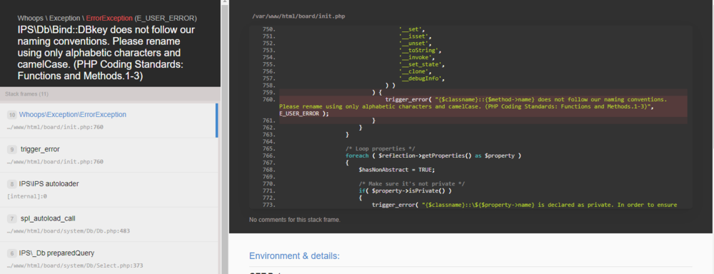

Witam , próbuje coś lepić na ipb , ale oczywiście są problemy '_. Po włączeniu trybu developera, dostaje takie coś, i nie mam pojęcia jak to ugryżć:

/* Loop methods */
$hasNonAbstract = FALSE;
$hasNonStatic = FALSE;
foreach ( $reflection->getMethods() as $method )
if ( \substr( $method->getDeclaringClass()->getName(), 0, 3 ) === 'IPS' )
/* Make sure it's not private */
if( $method->isPrivate() )
trigger_error( "{$classname}::{$method->name} is declared as private. In order to ensure that hooks are able to work freely, please use protected instead. (PHP Coding Standards: Functions and Methods.4)", E_USER_ERROR );
/* We need to know for later if we have non-abstract methods */
if( !$method->isAbstract() )
$hasNonAbstract = TRUE;
/* We need to know for later if we have non-static methods */
if( !$method->isStatic() )
$hasNonStatic = TRUE;
/* Make sure the name follows our conventions */
if(
!preg_match( '/^_?[a-z][A-Za-z0-9]*$/', $method->name ) // Normal pattern most methods should match
and
!preg_match( '/^get_/i', $method->name ) // get_* is allowed
and
!preg_match( '/^set_/i', $method->name ) // set_* is allowed
and
!preg_match( '/^parse_/i', $method->name ) // parse_* is allowed
and
!preg_match( '/^setBitwise_/i', $method->name ) // set_Bitiwse_* is allowed
and
!in_array( $method->name, array( // PHP's magic methods are allowed (except __sleep and __wakeup as we don't allow serializing)
'__construct',
'__destruct',
'__call',
'__callStatic',
'__get',
'__set',
'__isset',
'__unset',
'__toString',
'__invoke',
'__set_state',
'__clone',
trigger_error( "{$classname}::{$method->name} does not follow our naming conventions. Please rename using only alphabetic characters and camelCase. (PHP Coding Standards: Functions and Methods.1-3)", E_USER_ERROR );
I nic mi to nie mówi , kawałek kodu wziąłem z githuba, z nulledu ipb aż ciekawe że jest tam sobie , i porównałem ze swoim i niby to samo , może to że działam na localu ma jakiś wpływ ?
Czekaj, jeszcze raz. Masz najnowsze IPS4 pobrane z panelu klienta i po włączeniu trybu DEV wyskoczyło Ci to co wyżej, tak?

Teraz, DawPi napisał:
Wrzuciłeś?
Nie rozumiem pytania.
Tak dokładnie wrzuciłem i po dodaniu do constant.php mam, takie info jak w pierwszym wątku.

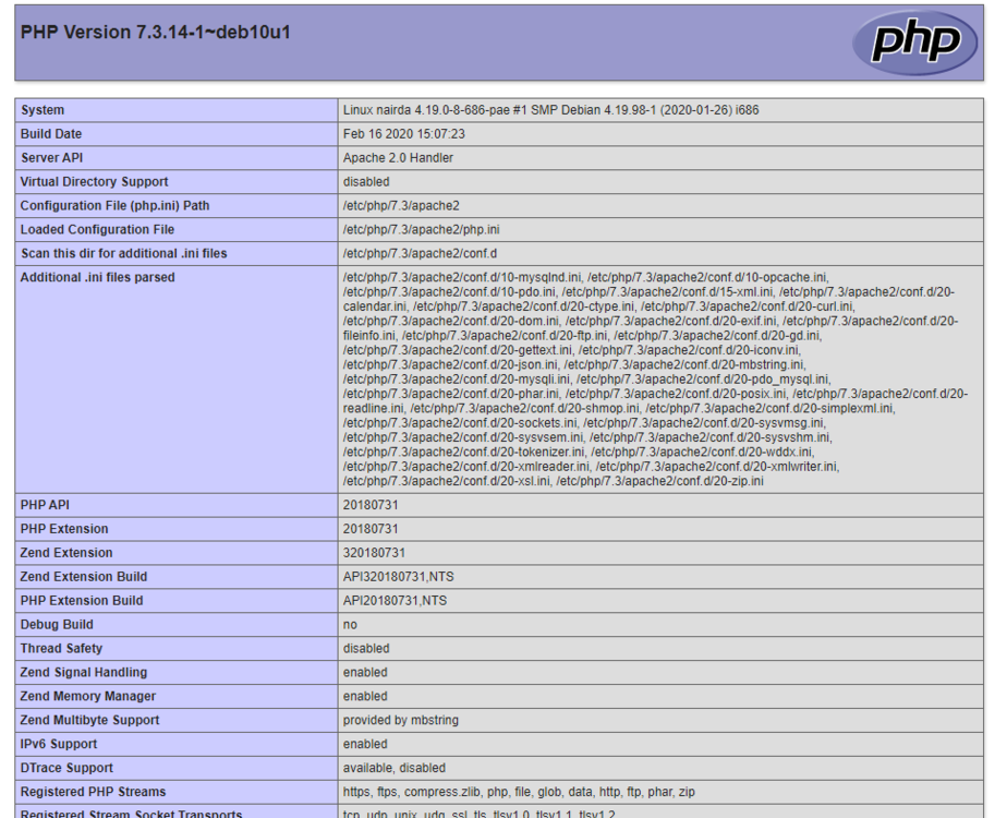

1 minutę temu, DawPi napisał:
Jaka wersja PHP? Windows kiedyś zmieniał wielkość znaków w nazwach plików. Na pewno nie masz zmodyfikowanych nazw plików jakie wrzuciłeś na localhost?
Wersja PHP  to jak na screenie:
Co do znaków wszystko, ok serwer stoi na debianie. Konfiguracja wydaje się poprawna nez trybu dev działa wszystko ok. Co do znaków , sprawdziłem jeszcze z poziomu debiana i wszystko się zgadza już drugi dzień się zastanawiam gdzie jest błąd.
